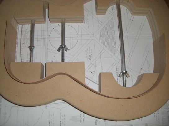

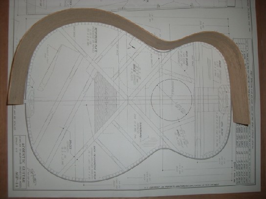

well,this is my fourth and latest attempt. i must say, i am very happy with the results this time around. almost zero springback on the upper and lower bouts with some spring back at the waist. to be honest im not sure if it is springback or if i just need to do some more sanding on the waist caul. this last time around it looked like the caul was not making it all the way down. i think i need to do some more sanding at the longest outer edges. anyways, i used craft paper dipped in water this time and i think that was part of the magical formula. the other thing i did different this time was bending the waist last. just a bit of "friendly friction" as john hall put it. it seems like this pulled everything tighter. i also used some twine to tie the bottom spring slat down when i was taking the wood out. this kept the slat from pushing out against the freshly bent wood.

Congratulations Heath, looks great!

I've read this post with great interest....Lots of good info and tips.... I keep going back and looking at your bending jig....It looks great,but I suspect its also part of the problem...To much mass....I suspect that the initial heating is no problem....The problem comes when the bend is made. Most of the heat is transfered to the jig and the temperature drops off drastically and it takes a lot of time to get the temp back up...I used copper pipe between my forms and I can maintain 300 (or higher)degrees and complete the process in about five or six minutes....Just my opinion, its all a learning experience....Lab

yeah, welcome larry. thanks for the observation, but i think i agree with todd on this one. it seems like more moisture made all the difference in the world. really great learning experience for me. im sure every step along the way will be packed with plenty of "learning experience" - read expensive and time consuming. but hey, im up for the challenge. nothing really great in life is free. thats for sure. thank you to everyone who walked me through this. you guys rock.
